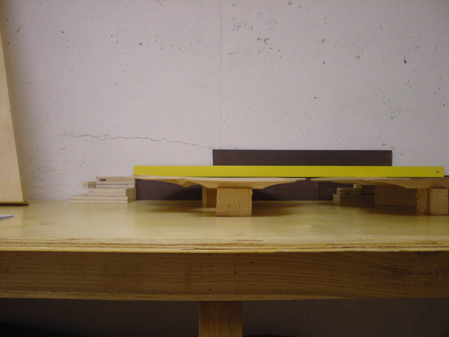

Hello All,
Well, let me first say, that I apologize, for ever starting the topic several weeks ago, “Is humidity really an issue”.
They say “experience is the best teacher”, and I got a big dose of it lately!
Recently I started a topic “Planning my next build!” which I got some good advise on where to go
with wood choices. JJ Donohue brought up a point that got me thinking, so, I posted a few pics
of the top & back set in question with edge views. That’s when the lesson began! It didn’t take
long for Don Williams, and Hesh to realize what had happened to the top & back! Yep! You guessed it!
TOO MUCH HUMIDITY!

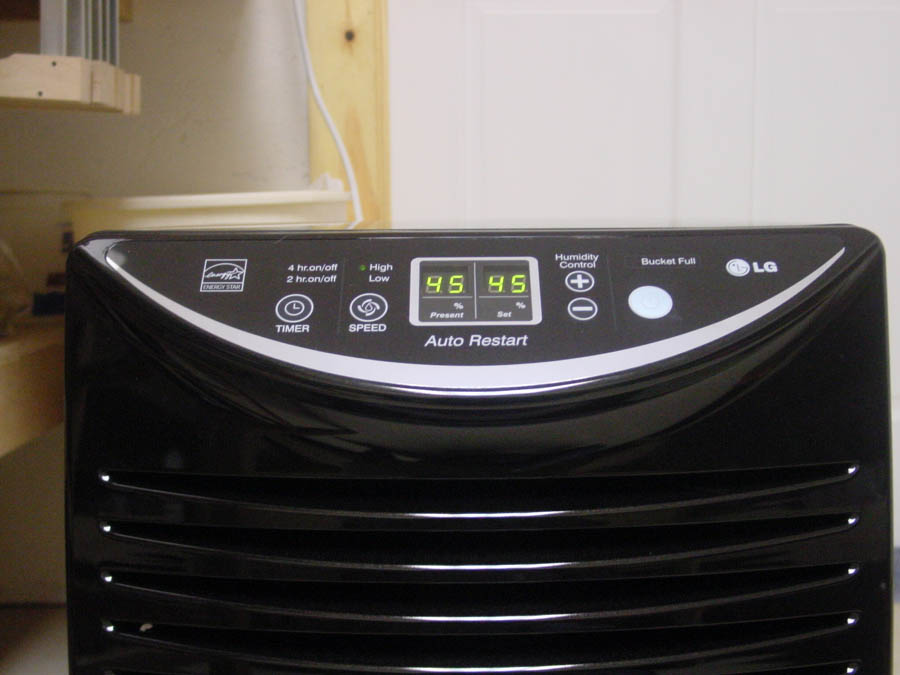

So, at the request of one the OLF tutorial masters “Hesh” and, after buying a new de-humidifier.
I’m recording the process of getting my shop to an acceptable RH.

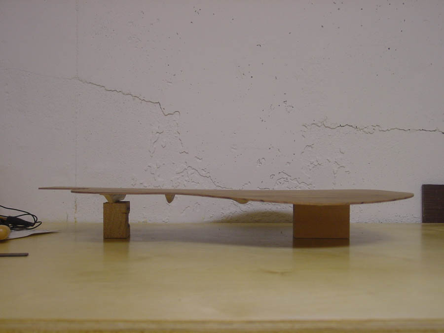

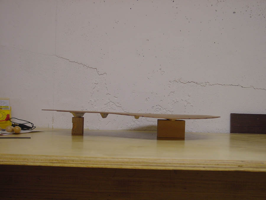

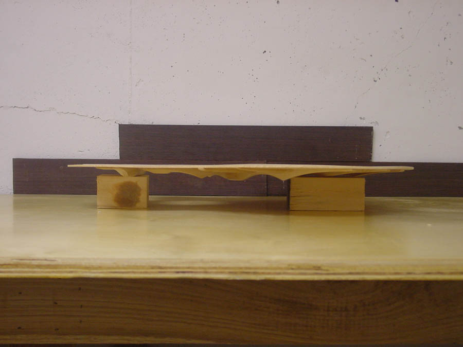

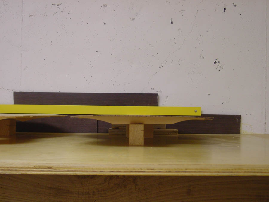

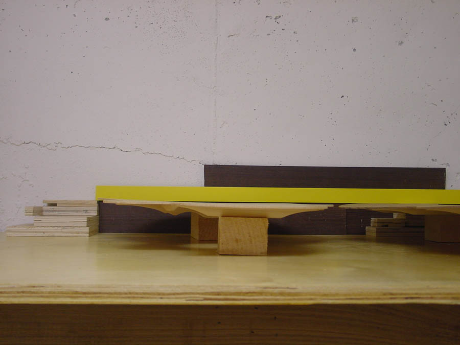

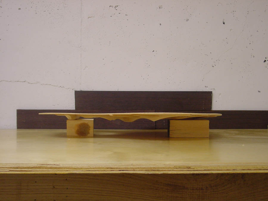

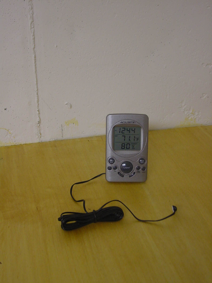

Starting at 80% humidity, and though only just over 24 hrs. I thought you might want to see what
I’ve got so far. It’s amazing to me that in just 24 hrs. there have been very noticeable changes.

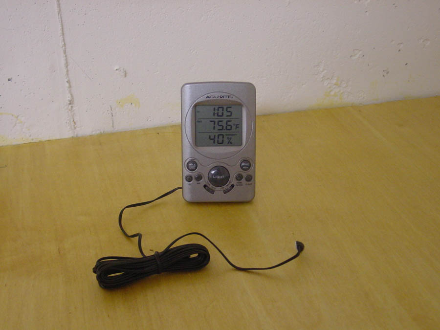

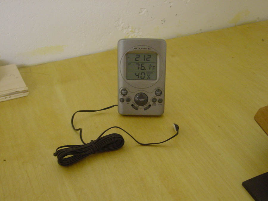

I lost the first pic of the new de-humidifier when I first turned it on, but, it was set to 45%RH
and the actual humidity was reading 70%RH on the de-humidifier it self. This at first was a little
confusing, because my other humidity meter that I keep on the bench was reading 80%. Things
did seem to even out after 24 hrs. had past. And, I suppose that will continue for several more days.
The first pic is a log I started. The rest are in chronological order with titles corresponding to the log.
The Log
Humidity Meter

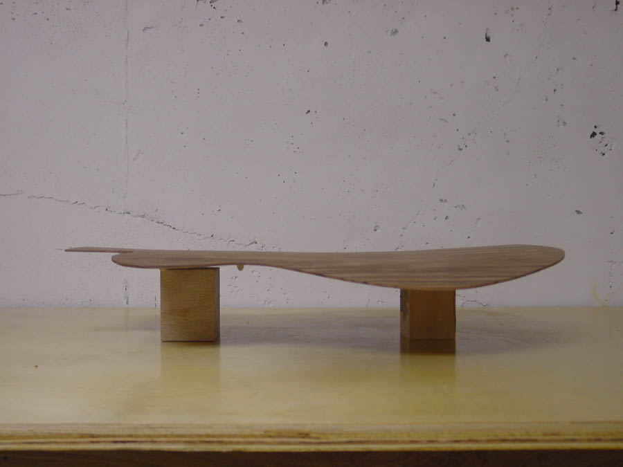

Top at 80 RH
Top side view at 80 RH
Back at 80 RH
Back side view at 80 RH
Humidity Meter

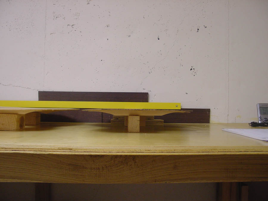

Top at 38 RH
Back at 38 RH
Humidity Meter
New dehumidifier
Top at 40 RH
Top side view at 40 RH
Back at 40 RH
Back side view at 40 RH
If you got'em ask'em!
Robert

wow man, that is crazy! what a huge difference. i also have been wondering about humidity for quite some time. like you mentioned, is it really that big of a deal? well, i guess we know the answer to that! i recently bought a digital hygrometer, and while im not sure of the precision of the intrument, the readings that i found in my house and shop were pleasantly surprising. inside my house with the a/c set at 78 degrees, humidity has stayed between 39% and 43% in a 48 hour period. not bad. outside is a bit different. temperature ranges from over 100 degrees in the day to around 80 over night. humidity fell as low as 30%, but i guess thats better than 80%! im glad you got your humidity situation all figured out. thats pretty exciting. now happy building!
sweat the small stuff.

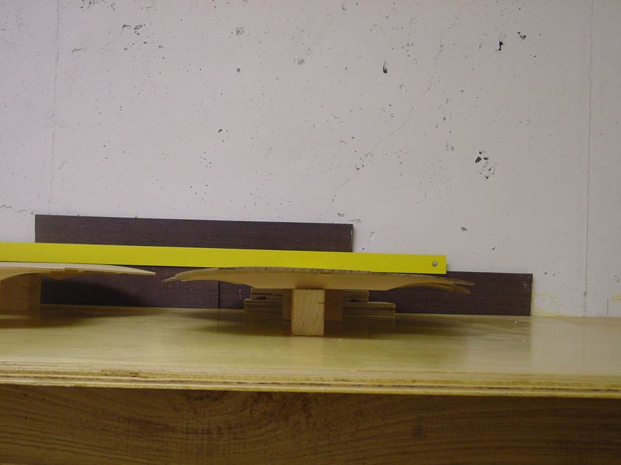

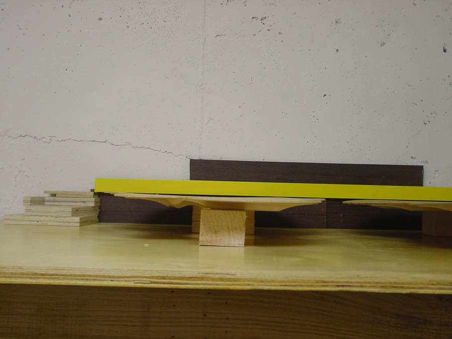

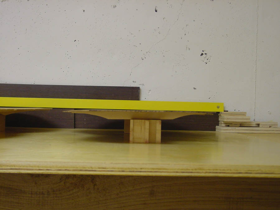

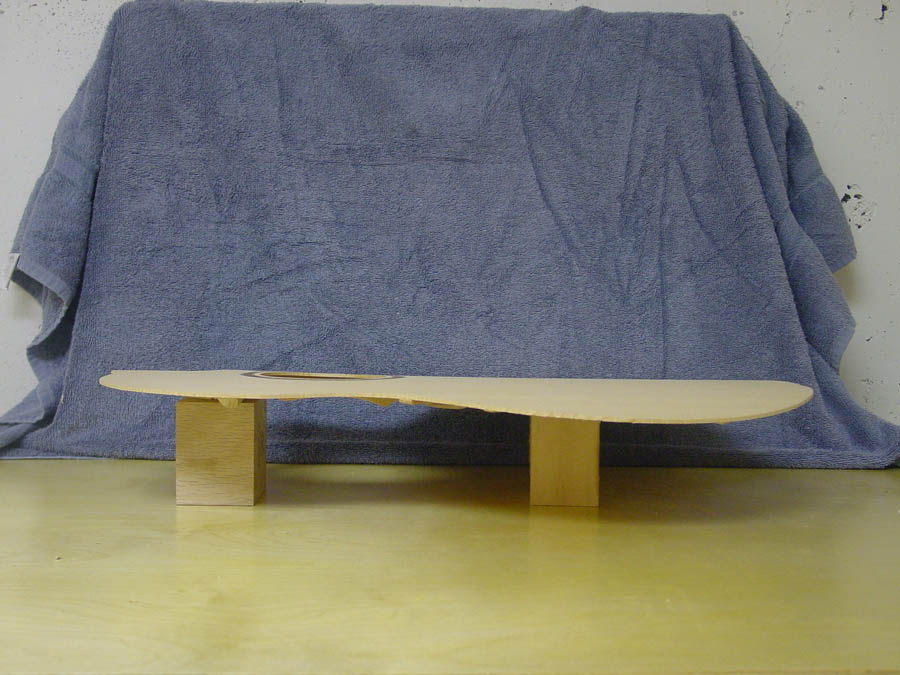

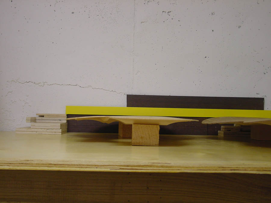

The following is an update, and just a little over 24 hrs. from the last set of pics. I’m thinking that
this set of pics will be all that is necessary to follow up on, since there is very little change, if any.
If I notice any significant changes over the next few days, I’ll be sure to post them.
Unfortunately, there may still be a problem with the top. It seems to have become slightly concave.
The opposite of what it was at 80% RH. Maybe it’ll straighten out over the next few days.
Here are the updated pics
The Log Updated
Humidity Meter
Top at 40% RH July 10, 2007
Top side view at 40% RH July 10, 2007
Back at 40% RH July 10, 2007
Back side view at 40% RH July 10, 2007
Thanks Looking,
Robert
PostPosted: Tue Jul 10, 2007 7:02 am
Robert...here's a thought to get the dome back.
Slightly dampen the surface and gobar clamp it into the appropriate radius dish for a day or 2.
Once removed from the dish, immediately glue it to the rims.
I have never had to try this but it just might work...and if it doesn't you can always remove it and go to plan "B"

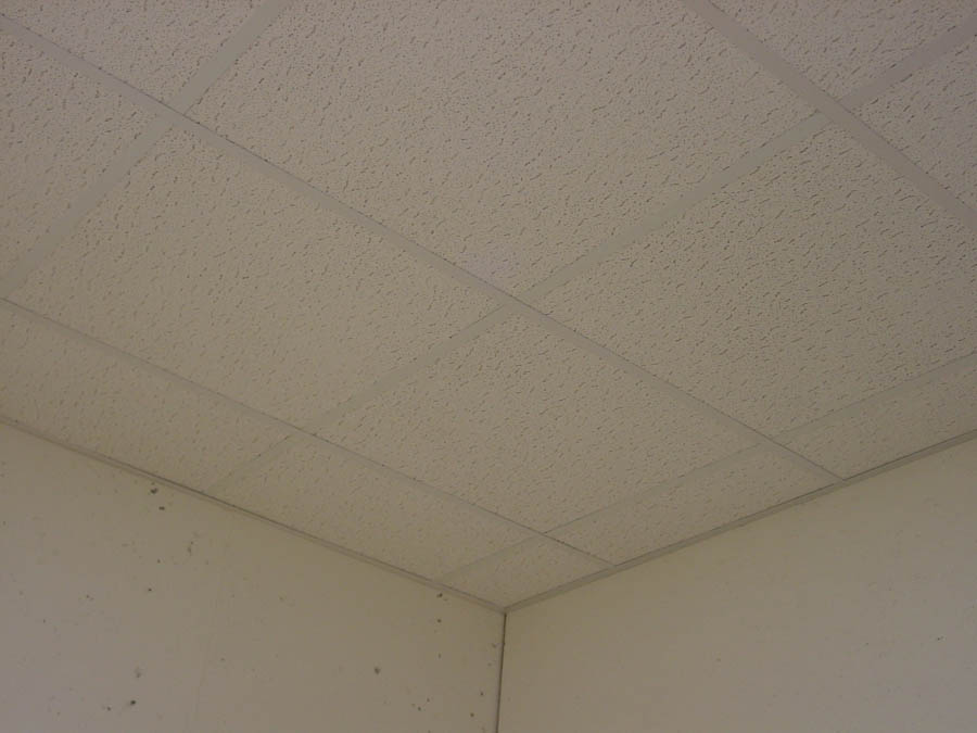

OK, this is kind of an update. I got to thinking about my ceiling in my new shop, (pic below) they
are the standard drop ceiling tiles. What they are made of I’m not completely sure of, however,
I would think some kind of paper product and fibers. One thing I do know, is they are very absorbent.
I’m guessing that these ceiling tiles are in a constant state of humidity changes, since it is
80% RH above the ceiling, and at least ? that in my shop. So, I thought I should get some plastic,
and line the top side of the tiles in order for the tiles stay at the RH of my shop. What do you think?
Also, after reading the link that Hesh posted, I got started on the salt test for my (Lowes bought)
hydrometer (pic below). I’ll let you know how that works out.
The last pic, I think is rather interesting. In the link I just mentioned, I saw where Hesh put all 3
of his hydrometers together, so as to compare their readings. I put my hydrometer on top of my
de-humidifier early this morning, and.... well you be the judge!

i wouldn't worry about the ceiling. my air conditioning system and my old dehumidifier has little trouble keeping my wood room around the 45-47% mark. the only time it goes higher is when we have a major cloudburst, like yesterday evening, but this a.m. it was back to where it should be. the general workshop area takes a little longer.
